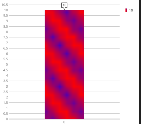

Having issues with giving a single bar in a series a hatch style. I've included a minimum working example, where each generated image (53 in total) each look identical (matching the image provided below).
foreach (HatchStyle hatchStyle in Enum.GetValues(typeof(HatchStyle)))
		TChart barChart = new TChart();
        Bar bar = new Bar();
        bar.Add(10);
        bar.Brush.Style = hatchStyle;
        bar.Brush.Color = Color.Red;
        bar.Brush.ForegroundColor = Color.Blue;
        barChart.Series.Add(bar);
		// Export specifics
		var png = barChart.Export.Image.PNG;
        png.Width = 550;
        png.Height = 550;
        png.Save(@"C:\Users\...\HatchStyle" + hatchStyle + ".png");

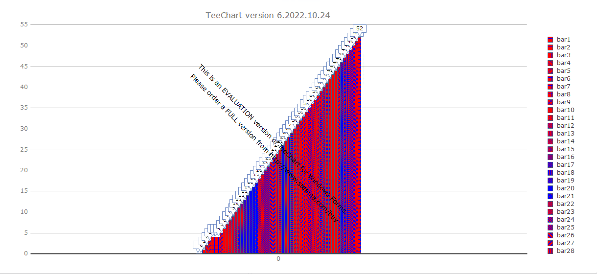

sorry for the delay in our reply. I think your result is expected, as for each loop you are creating a new instance of TChart. If I run the following code:
    private Steema.TeeChart.Styles.Bar bar1;
      foreach (Steema.TeeChart.Drawing.HatchStyle hatchStyle in Enum.GetValues(typeof(Steema.TeeChart.Drawing.HatchStyle)))
        bar1 = new Steema.TeeChart.Styles.Bar(tChart1.Chart);
        bar1.Add((int)hatchStyle);
        bar1.Brush.Style = hatchStyle;
        bar1.Brush.Color = Color.Red;
        bar1.Brush.ForegroundColor = Color.Blue;
      tChart1.Header.Text += $" version {Steema.TeeChart.Utils.Version}";
I get what I think you expect:
Screenshot from 2022-11-21 09-42-06.png (81.13 KiB) Viewed 7530 times

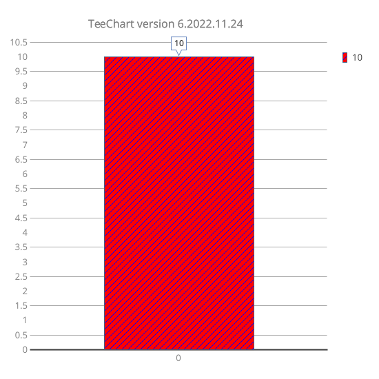

These styles have now been partially implemented in the latest TeeChart Pro/Business NuGets. The following code:
            var bar1 = new Steema.TeeChart.Styles.Bar(tChart1.Chart);
            bar1.Add(10);
            bar1.BarWidthPercent = 100;
            bar1.Brush.Style = Steema.TeeChart.Drawing.HatchStyle.BackwardDiagonal;
            bar1.Brush.Color = System.Drawing.Color.Red;
            bar1.Brush.ForegroundColor = System.Drawing.Color.Blue;
            var png = tChart1.Export.Image.PNG;
            png.Width = 550;
            png.Height = 550;
            png.Save(path);
            new Process
                StartInfo = new ProcessStartInfo(path)
                    UseShellExecute = true
            }.Start();
Now gives us:
This is a partial implementation, each implementation of a HatchStyle was much more time consuming that we had originally appreciated—if you find a HatchStyle that is not implemented but that you wish to use, please tell us and we will implement it for you.
