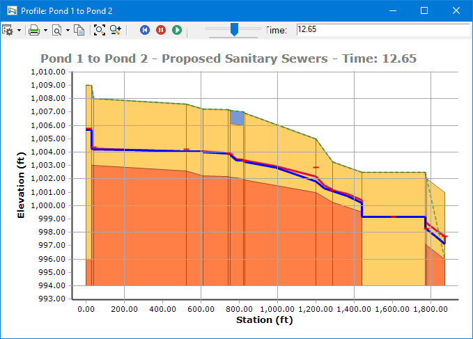

The first image is from our current release that uses v2009:
Graph before upgrading to v2022

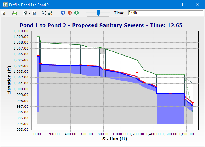

This is the same graph after upgrading to TeeChart v2022:
Graph after upgrading to v2022
If the colors were simply a variation on the shade of grey, that would be one thing. But to go from grey to orange is something completely different. I checked our code and we are using Color.LightGrey. How does that translate into orange by anyone’s imagination?

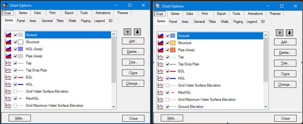

Here are the graph options. Left is pre-upgrade and right is post-upgrade:
Graph Options - Pre and Post Upgrade
In the options on the right there is a series missing (HGL (Area)) and the colors are wrong.
