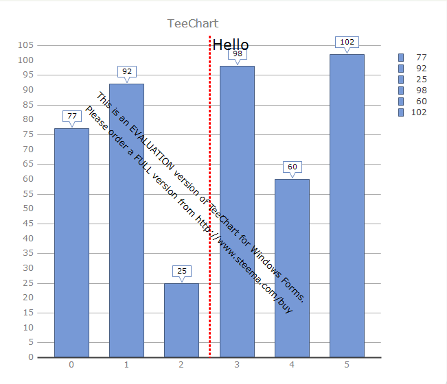

hello:
I got a question, That's how to realize custome line ?
Just like the color line in demo, but i need to add the custome label above the end of the line and make the solid line to be dotted line
Re: Realize custome line
Post by Christopher » Mon Feb 06, 2023 9:08 am
you can change the style of the ColorLine Pen by using the Pen.Style property, e.g.
        readonly ColorLine colorLine;
            var bar = new Bar(tChart1.Chart);
            bar.FillSampleValues();
            colorLine = new ColorLine(tChart1.Chart)
                Axis = tChart1.Axes.Bottom,
                Value = 2.5
            colorLine.Pen.Width = 3;
            colorLine.Pen.Color = Color.Red;
            colorLine.Pen.Style = Steema.TeeChart.Drawing.DashStyle.Dot;
            tChart1.AfterDraw += TChart1_AfterDraw;
        private void TChart1_AfterDraw(object sender, Steema.TeeChart.Drawing.IGraphics3D g)
            g.Font.Size = 16;
            g.TextOut(tChart1.Axes.Bottom.CalcXPosValue(colorLine.Value), tChart1.Axes.Left.IStartPos, "Hello");
