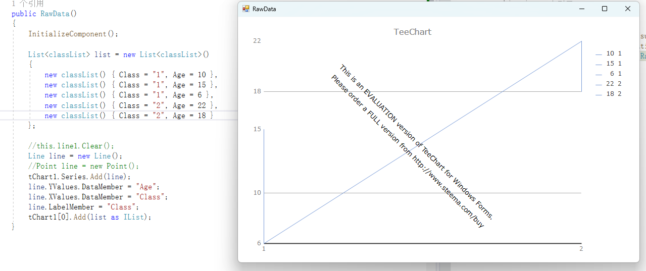

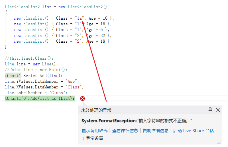

when i use TeeChart draw the data , I hope when Class value is same then the Y will in vertical line like the picture
But when I use string value, I got the error
I hope place the X value with difference data like product ID ,the data like:P1,P2,P3, is string array
then teechart show chart with same product ‘s data on vertical line。
my code is

the error like teechart can't accpt string data, but i need use string array on X value to Implemente my requirement

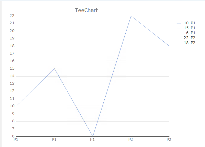

The following code:
            var line = new Line(tChart1.Chart);
            InitializeChart(line);
        public class ProductInfo
            public string Product { get; set; }
            public int Y { get; set; }
        List<ProductInfo> list = new List<ProductInfo>()
            new ProductInfo() { Product = "P1", Y = 10 },
            new ProductInfo() { Product = "P1", Y = 15 },
            new ProductInfo() { Product = "P1", Y = 6 },
            new ProductInfo() { Product = "P2", Y = 22 },
            new ProductInfo() { Product = "P2", Y = 18 }
        private void InitializeChart(Line line)
            line.YValues.DataMember = "Y";
            //line.XValues.DataMember = "Product";
            line.LabelMember = "Product";
            tChart1[0].Add(list as IList);
gives me the following Chart:
Screenshot from 2023-07-28 12-58-22.png (28.75 KiB) Viewed 56087 times
Is this Chart what you want? If not, what do you want to see?

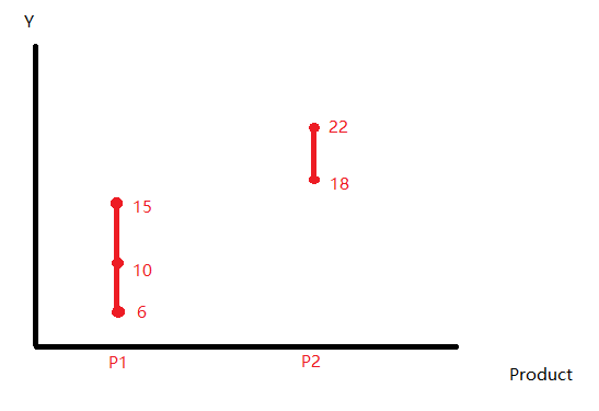

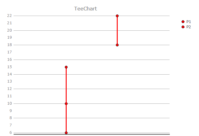

The Chart I want to see is below

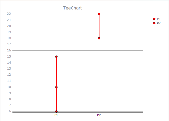

Re: How to set the X with category data?
Post by Christopher » Mon Jul 31, 2023 8:48 am
okay, in which case you can use:
            var line1 = new Line(tChart1.Chart);
            var line2 = new Line(tChart1.Chart);
            var product1 = "P1";
            var product2 = "P2";
            InitializeChart(line1, product1);
            InitializeChart(line2, product2);
            tChart1.Axes.Bottom.SetMinMax(-1, 2);
            //with more than one series in the chart we need to set the
            //labels manually like this:
            tChart1.Axes.Bottom.Labels.Items.Add(0, product1);
            tChart1.Axes.Bottom.Labels.Items.Add(1, product2);
            public int X { get; set; }
            new ProductInfo() { X = 0,  Product = "P1", Y = 10 },
            new ProductInfo() { X = 0, Product = "P1", Y = 15 },
            new ProductInfo() { X = 0, Product = "P1", Y = 6 },
            new ProductInfo() { X = 1, Product = "P2", Y = 22 },
            new ProductInfo() { X = 1, Product = "P2", Y = 18 }
        private void InitializeChart(Line line, string select)
            line.LinePen.Width = 3;
            line.Color = Color.Red;
            line.Pointer.Visible = true;
            line.Pointer.Style = PointerStyles.Circle;
            line.XValues.DataMember = "X";
            line.Title = select;
            line.Add(list.Where(x => x.Product == select).ToList() as IList);

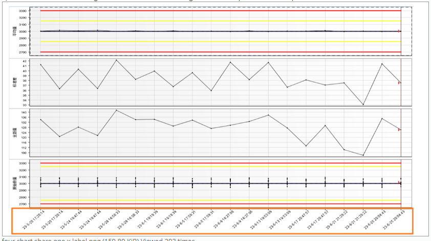

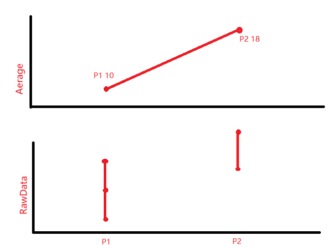

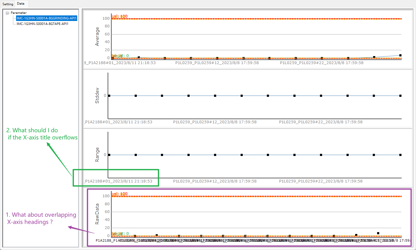

1. Problems with the first picture
1) As shown in the image above, "Raw Data" Chart is drawn this way, but what about overlapping X-axis headings ?
2) What should I do if the X-axis title overflows?

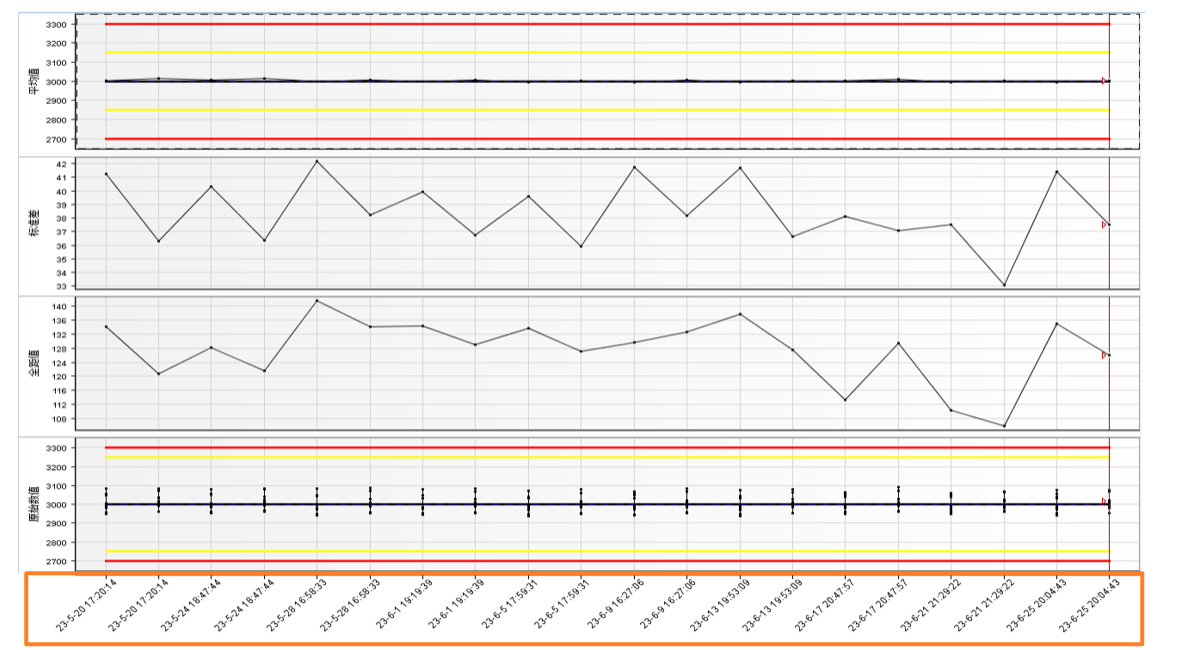

3) Can the four x axes in the figure above share one? In the figure below, the points can correspond to the X-axis label
four chart share one x label.png (159.89 KiB) Viewed 55632 times

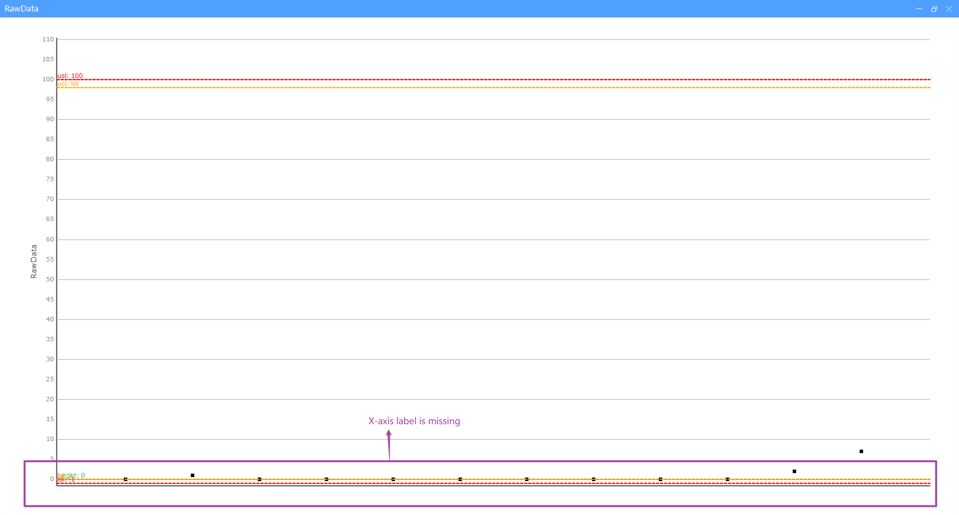

2. Problems with the second picture

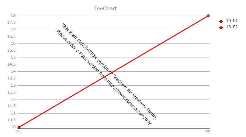

X-axis label is missing.png (24.45 KiB) Viewed 55638 times
As shown in the image above,"Raw Data" Chart added double click method, X-axis label is missing, double click method is as follows
public void chart_DoubleClick(object sender, EventArgs e)
            TChart chart = (TChart)sender;
            using (TChart nChart = DeepClone.DeepCloneCopy(chart))
            using (UIForm dialog = new UIForm())
                nChart.AfterDraw += Chart_AfterDraw; // 处理彩色线的 Label
                dialog.Text = nChart.Axes.Left.Title.Text;
                dialog.WindowState = FormWindowState.Maximized;
                dialog.Controls.Add(nChart);
                nChart.Dock = DockStyle.Fill;
                dialog.ShowDialog();
                dialog.Close();
Posts: 1319

Re. Problem 1.
How are you adding the data labels? What code. Axis labels normally automatically separate when added, some circumstances override that behaviour. Your code is relevant to understanding the cause of the problem.
Yes, see the example here:
https://github.com/Steema/TeeChart-NET- ... iScroll.cs

Question:
Double click chart. After deep copy, render the copied chart. The X-axis label is lost.As shown below
And the bound events are lost. For example:line.GetPointerStyle += Line_GetPointerStyle; nChart.AfterDraw += Chart_AfterDraw;

Post by Marc » Tue Aug 22, 2023 7:01 am
Not being sure about the definition of the deepclone or the UIForm dialogue form I used a Chart export and import and standard form. I noticed that the Axis Label Item collection didn't copy properly so I added the copy manually. I put some code in OnAfterDraw and it all seems to work ok:
private void tChart1_DoubleClick(object sender, EventArgs e)
    MemoryStream ms = new MemoryStream();
    chart.Export.Template.Save(ms);
    using (TChart nChart = new TChart())
    using (Form dialog = new Form())
        ms.Position = 0;
        nChart.Import.Template.Load(ms);
        nChart.Axes.Bottom.Labels.Items.Clear();
        foreach (Steema.TeeChart.AxisLabelItem axItem in tChart1.Axes.Bottom.Labels.Items)
            nChart.Axes.Bottom.Labels.Items.Add(axItem);
        nChart.AfterDraw += tChart1_AfterDraw; // 处理彩色线的 Label
        dialog.Close();
private void tChart1_AfterDraw(object sender, Steema.TeeChart.Drawing.Graphics3D g)
    ((Steema.TeeChart.TChart)sender).Graphics3D.TextOut(20, 20, "hello world");

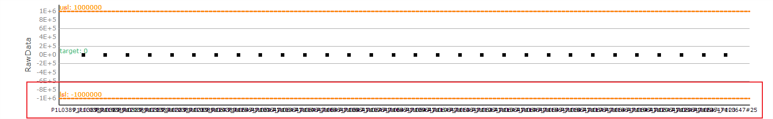

Mean chart code as follow

        List<ProductInfo> rawList = new List<ProductInfo>()
        public RawDataAverage()
            Line line = new Line(tChart1.Chart);
            InitializeChart(rawList, line);
        private void InitializeChart(List<ProductInfo> list, Line line)
            System.Console.WriteLine(rawList);
            line.Add(rawList as IList);
RawData chart code as follow
            tChart1.DoubleClick += new EventHandler(this.chart_DoubleClick);
Question1: When RawData Chart has a lot of data, the X-axis labels are stacked together. Want to clearly show how to deal with them?
The following figure shows an example of X-axis labels stacked together
x label.png (13.42 KiB) Viewed 55467 times
Question2:Average Chart and RawData ,the X-axis is the same and I want to share an X-axis
coldwind
Posts: 41
Joined: Tue Dec 27, 2022 12:00 am
Post by coldwind » Tue Aug 22, 2023 12:44 pm
share an X-axis.png (8.41 KiB) Viewed 55460 times
The following is an example of four graphs sharing an X-axis,I expect the same for my two drawings

Question 1.
I suggest that either you make the labels multiline (can use \n char) or put the labels angle to 90º.
We will look at ways to better plot default labels for contiguous series.

Question 2.
Similar to the link I sent you in an earlier email you would place the charts one above the other, use the same SetMinMax axis settings and set AxisLabels Visible false for the top chart. Best to fix left and right margins for both charts. What particular problems are you encountering?
coldwind
Posts: 41
Post by coldwind » Mon Aug 28, 2023 1:28 am
Hello, you do not understand what I mean, the last example diagram, the four diagrams are separate diagrams, but the X-axis is only the last diagram, and the other three diagrams share the last X-axis, their points are the same vertically
