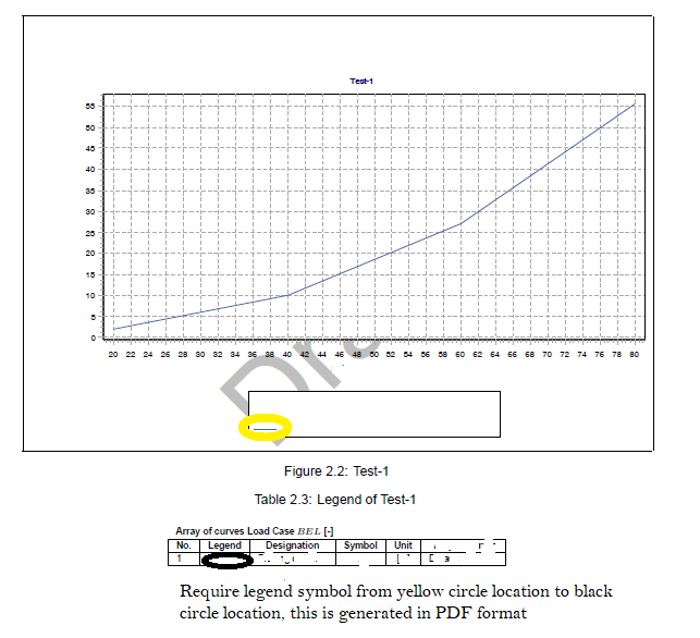

this solution shall modify the changes at legend section, but we want to use that symbol at customized project specific editor like PDF table and there need to repaint/redraw the symbol of the specific series as shown in this attachment
This image is generated in PDF file. So any way to get this as a shape?

We want to do vice versa. We want to use legend symbol of a chart in a our PDF table so is there any way by which i can get series and its legend symbols.

You can't get the symbol itself but you can get most of the information you need to plot it. The event from the previous examples offers up the rectangular size of the symbol to be plotted and the colours can be extracted from the Series value index, then knowing if you're going to have a square, triangular or line symbol according to default Chart settings, just use the PaintEventArgs e.Graphics in Form_paint or similar, to plot the symbol where you want it.
