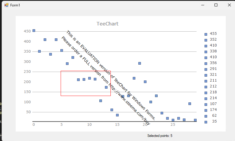

Hi, I have a question about T-chart.(Steema TeeChart for .NET Source Code 2023 4.2023.06.14 (.NET8 Compile))
While dragging and specifing some points(series) in chart, I need to get (x,y) points value in dragged area.
Is there any function or a way that I can use for it?
If so, plz let me know.(With example would be the best)
Thank you.

There are multiple ways to achieve this. I'll show you an example.
First, declare two Points, for example, "up" and "down".
        Point down, up;
Then, through these events we can give values to those points.
            tChart1.MouseDown += TChart1_MouseDown;
            tChart1.MouseUp += TChart1_MouseUp;
         private void TChart1_MouseDown(object sender, MouseEventArgs e)
            down = new Point(e.X, e.Y);
         private void TChart1_MouseUp(object sender, MouseEventArgs e)
            up = new Point(e.X, e.Y);
I made the trigger be a button-click, but you can do it however you need.
Like so:
            double xMin = tChart1.Axes.Bottom.CalcPosPoint(down.X);
            double xMax = tChart1.Axes.Bottom.CalcPosPoint(up.X);
            double yMin = tChart1.Axes.Left.CalcPosPoint(down.Y);
            double yMax = tChart1.Axes.Left.CalcPosPoint(up.Y);
             //Example: storing what points(X,Y) are inside the rectangle.
            List<PointF> points = new List<PointF>();
            for (int i = 0; i< myPoints.Count; i++)
                double x = myPoints.XValues[i];
                double y = myPoints.YValues[i];
                if (x >= xMin && x <= xMax && y >= yMin && y <= yMax)
                     //The point x and y is inside the rectangle.
                    points.Add(new PointF((float)x,(float)y));
	    //Example
            label1.Text = $"Selected points: {points.Count}";
            foreach (PointF p in points)
                Console.WriteLine($"({p.X},{p.Y})");
Please note that I'm only demonstrating how to display the number of selected points and outputting this to the console. You should handle your data in whatever way best suits your needs.
Additionally, when getting my "xMin, xMax, yMin, yMax", I am assuming I will always draw the rectangle (mouse down, mouse up) the same way: from bottom left to top right. If you plan to drag a rectangle in different ways, you may want to improve how you decide which value is which (x max, x min.. etc) to avoid possible errors. For example:
        private void Alternative()
            double xMin, xMax, yMin, yMax;
            if (tChart1.Axes.Bottom.CalcPosPoint(down.X) > tChart1.Axes.Bottom.CalcPosPoint(up.X))
                xMin = tChart1.Axes.Bottom.CalcPosPoint(up.X);
                xMax = tChart1.Axes.Bottom.CalcPosPoint(down.X);
            // Then do the same with Y ...
If you need any further assistance, if the example wasn't clear enough, or if you notice any errors or mistakes, please don't hesitate to reach out.

And this is how it looks like:

Made a showcase for you: In this example, I want to have a button that erases the rectangle after I click it
        bool shouldRectangleBeDeleted = false;
        private void button_Click(object sender, RoutedEventArgs e)
            shouldRectangleBeDeleted = true;
            tChart1.Invalidate();
        private void TChart1_AfterDraw(object sender, IGraphics3D g)
            int startX = (int)Math.Min(down.X, up.X);
            int endX = (int)Math.Max(down.X, up.X);
            int startY = (int)Math.Min(down.Y, up.Y);
            int endY = (int)Math.Max(down.Y, up.Y);
            g.Brush.Transparency = 100;
            g.Pen.Color = System.Drawing.Color.Blue;
            if (shouldRectangleBeDeleted)
                g.Rectangle(0, 0, 0, 0); // inviisble rectangle
                shouldRectangleBeDeleted = false; // reset boolean check after erasing
                g.Rectangle(startX, startY, endX, endY);
Please note that this is a basic example to demonstrate how you can control the flow of your program. You have the flexibility to trigger actions using various methods, such as key presses, different conditions, or other input mechanisms beyond a simple boolean check. The specific approach you choose will depend on how you want your program to behave and the user experience you envision. Feel free to explore and implement the method that best suits your needs.
I only want to highlight some points in the series included in the square and try to redraw the chart.
Is it possible to refresh only the corresponding points or series from a large amount of data?
You can, for example, create another Series and populate them as you "find data points inside the rectangle". Then, make the first series ("myPoints") invisible, for example. Here are some lines of code to guide you:
1.- Setting up series
        Points myPoints;
        Points myHighlightedPoints;
         myPoints = new Points(tChart1.Chart);
         myHighlightedPoints = new Points(tChart1.Chart);
2.- Inside the loop in the afterdraw function, add the values to our new highlighted series
           if (minX <= xValue    && maxX >= xValue   && minY <= yValue   && maxY >= yValue)
                    pointsInsideRectangle.Add(new Point((float)xValue, (float)yValue));
                    myHighlightedPoints.Add(xValue, yValue); // add to highlighted series
3.- inside a button or after drawing a rectangle or wherever you want, make the first series invisible.
                  myPoints.Visible = false;
Keep in mind that if you use this approach, you'll have to empty the highlightedSeries after every other area selection, or else you'd be carrying over values from your previous select.
Also note that if you make the first series invisible, the chart will automatically move its axes to fit the new data points, making your square be "in the wrong place". To solve this issue, you can use properties like the following to lock in place your chart
tChart1.Axes.Bottom.Maximum = 100;  // Example value
tChart1.Axes.Left.Maximum = 100;
tChart1.Axes.Automatic = false;
Other approaches: You could even have a secondary tChart, which would be empty at first and then you could add the points highlighted on the main tChart.
There are many ways to implement these features, and the best approach will ultimately depend on your specific needs and preferences. I wanted to provide you with a few options to consider, but feel free to explore and choose the one that works best for you.
If there's anything else I can assist you with, or if you'd like to explore other approaches, please don't hesitate to let me know!
