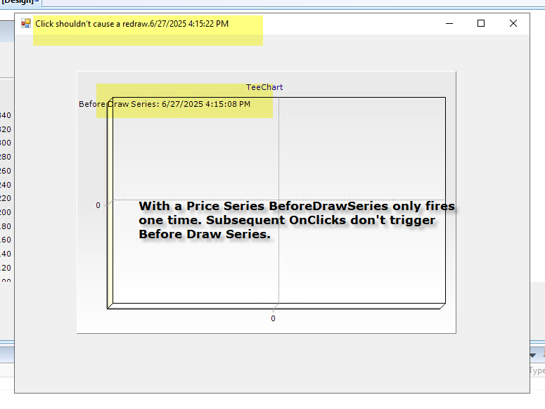

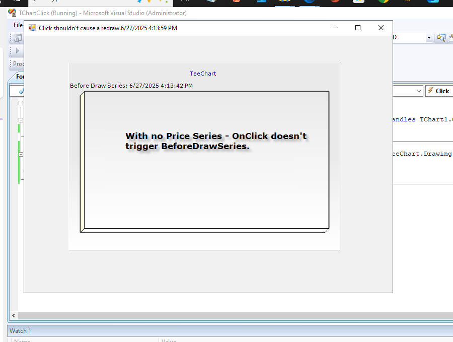

Post by jzarech » Fri Jun 27, 2025 11:48 pm
I'll try your fix tonight - I was able to get version of my old Visual Studio 2008 project:
3.5.3498.27368
And the new version is:
4.2025.5.7
And the charts do work significantly differently regarding eventing.
I'll attach a Visual Studio 2008 zip file with demo code and some screenshots.
