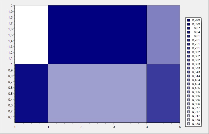

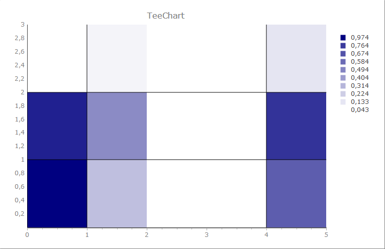

Revisiting this post of mine, I believe things have changed slightly. Using this code in TeeChart.NET gives us the corresponding image:
    private Steema.TeeChart.Styles.ColorGrid colorGrid;
      double x, y, z;
      Random rnd = new Random();
      int length = 2;
      tChart1.Series.Add(colorGrid = new Steema.TeeChart.Styles.ColorGrid());
      colorGrid.IrregularGrid = false;
      for (int i = 0; i <= length; i++)
        x = i * i;
        for (int j = 0; j <= length; j++)
          z = j;
          y = rnd.NextDouble();
          colorGrid.Add(x, y, z);
whereas in ActiveX/Delphi we have:
