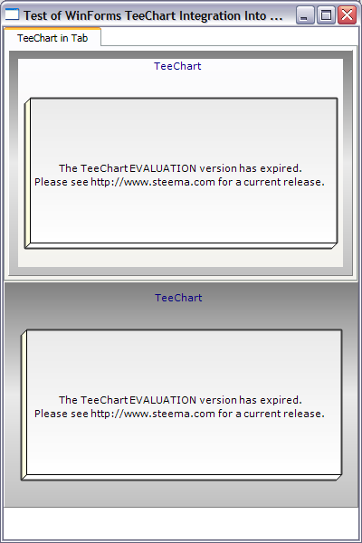

narcis wrote:Hi Walt,
We consider current WPF release being a production version already. ShowEditor is inherited from TChart class but the editor is not supported in WPF applications. I don't think there are plans for it either.
Would it be possible for you to make the WinForms editor work for the WPF control? I realize many types are different, but maybe this would be easier for you than writing an all-new WPF implementation. I would consider this acceptable as long as it is robust. The editor is usually used as a modal dialog, so there are no airspace issues to deal with.
On the other hand, if I am going to use the WinForms control inside a WPF app, then I do have airspace issues (can't put chart in a ScrollViewer). This is an issue with WPF, so I'm not expecting you to solve it (I'm looking into the solution posted here).
However, there is another issue with WPF integration. Please create a WPF application in VS2008, reference the regular WinForms TeeChart.dll, and try the following code:

Notice that the background for the first chart does not show everywhere that it should (there is a solid white background behind the chart title). For the second chart, there is no problem. (This is especially ugly if using a dark theme.)
The only difference is that the first chart is within a tab control. This problem also occurs when putting the chart in other containers such as those in the AvalonDock library. Other parts of the chart render ok, so it seems to be a bug in TeeChart.dll

I am using an evaluation of version 4.0.2009.16187.
The background behind the title in the first chart should not be solid white. In order to make this more noticeable, please change the XAML to the following:

Walt
Posts: 35
Joined: Wed Aug 17, 2005 4:00 am
Location: San Jose, CA
Re: ColorGrid Buggy in WPF Demo App
Post by Walt » Thu Aug 13, 2009 10:59 pm
Sorry for the late reply. Below is what I get. Maybe this is a weird video-card issue or something? This only happens with the WinForms control (not the WPF version), but I need to use the WinForms version in order to have access to the editor (and maybe other reasons). No matter what settings I change, I can not get rid of the white box behind the plot area and chart title. I am using .NET 3.5 SP1 (and VS2008 SP1).

Post by Sandra » Mon Aug 17, 2009 9:50 am
Hello Walt,
I couldn't reproduce your issue with last version of TeeChartFor.Net. Please, you could send us a simple example project because we can reproduce problem here? Now, you can attach your projects directly in formus post.
