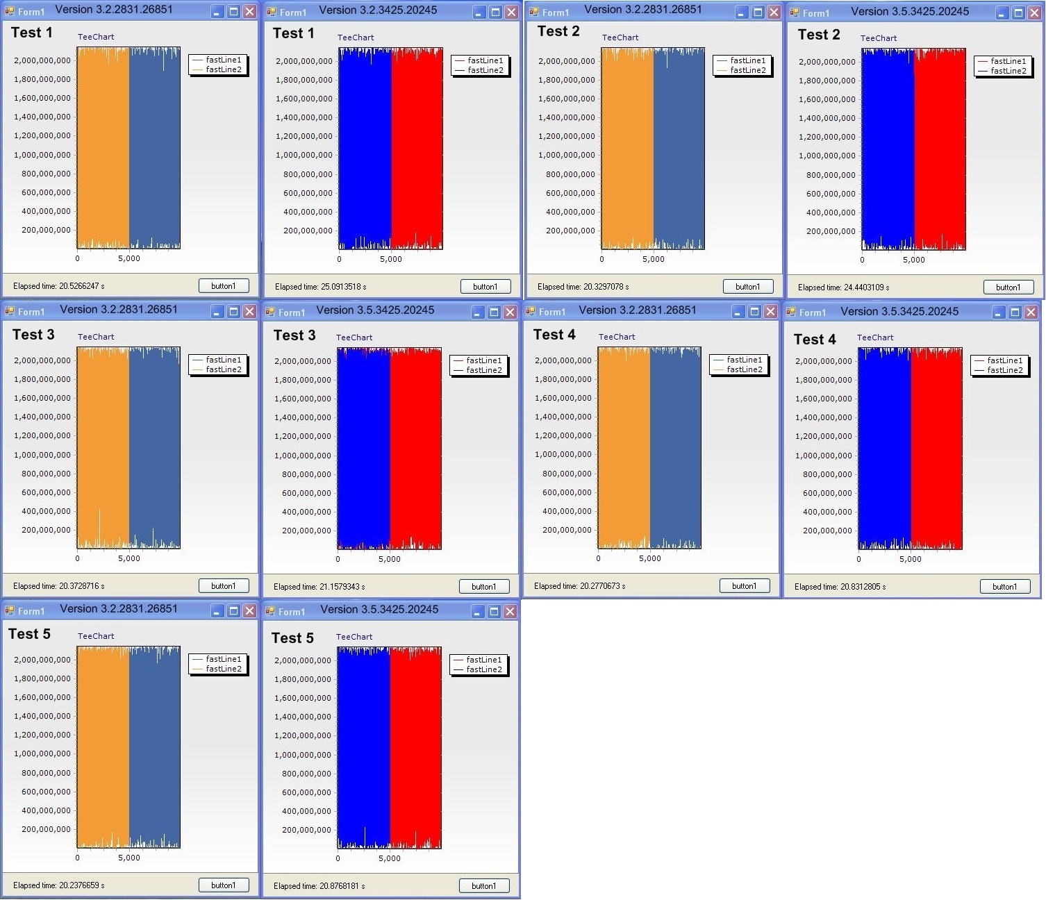

I have run the code you sent me and attached a file with screen shots of the results:
Test 1:
The target machine has been reboot.
Version 3.2.2831.26851 test is run, result: 20,5266247 sec.
Version 3.2.3425.20245 test is run, result: 25,0913518 sec.
Test 2:
Version 3.2.3425.20245 test is run, result: 24,4403109 sec.
Version 3.2.2831.26851 test is run, result: 20,3297078 sec.
Test 3:
Test 2 was run.
Version 3.2.3425.20245 test is run, result: 21,1579343 sec.
Version 3.2.2831.26851 test is run, result: 20,3728716 sec.
Test 4:
Test 3 was run.
Version 3.2.2831.26851 test is run, result: 20,2770673 sec.
Version 3.2.3425.20245 test is run, result: 20,8312805 sec.
Test 5:
Test 4 was run.
Version 3.2.3425.20245 test is run, result: 20,8768181 sec.
Version 3.2.2831.26851 test is run, result: 20,2376659 sec.
The applications are not closed between each test.
The target machine is an Intel Celeron M 1GHz, 480 MB ram.
Conclusion:
After a reboot the difference is significant higher than after several runs.
Still after several runs the difference is 600ms, which makes a difference on the system when it's loaded additional.
Test results
Test results.jpg (482.06 KiB) Viewed 7387 times

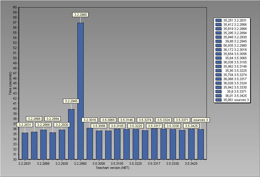

Posts: 9701
Re: Download TeeChart version 3.2.2831.26851
Post by Yeray » Tue Jul 07, 2009 10:41 am
Hi mgc,
I've ran more or less the same code than before 10 times for each TeeChart dll and calculated the mean. See the attached image showing the results of the tests (Pentium 4 @1,7GB, 512MB RAM, GeForce2 GTS 32MB).
As you'll see, there are significative performance differences with v3.2.2945 and 3.2.2980. But the difference between the v3.2.2831 and the other versions is less than a 2%, and considering all the changes they suffer that implies a lot of bug fixing and other improvements, we think that this is an acceptable sacrifice.
Here is the code I've used for the tests (I've compiled it in release mode):
