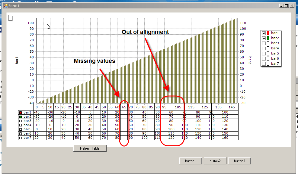

There are a few painting issues that I have seen with the datatable tool. I have uploaded a pair of screenshots:
Datatable paint issues1 and 2.png (tested with v3.5.3425.20245)
1) Some coloumns do not paint values, even though the values exist
2) When zooming in and out, sometimes the values are painted over a column border.

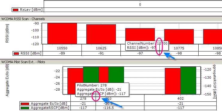

Datatable paint issues3.png (tested with v3.5.3371.26405)
3) Column borders are painted in front of other objects. In this example, the annotation is painted on top of (and hides) the values shown in the table (which is correct behavior). However the table borders are painted on top of the annotation box.
I could reproduce your problem and I have added to the list of Bug Report with number [TF02014272] we will try to fix it for next versions of TeeChart .NET.
I could not reproduce your problem with last versions of TeeChartFor . Net (version 4 and version 3). Please check your code with last update of version 3. If your problem still appears. Please, could you send us a simple example project we can run "as-is" to reproduce the problem here?. Now, you can put your project directly in the post, using new property of forums upload attacments.

Also,
using 4.0.2009.35592, I am able to reproduce the issue #3 in which items showing through the annotation box. I have attached another screenshot demonstrating this issue.

Also,
We couldn't reproduce your isseu using next code:
            Steema.TeeChart.Styles.Bar bar1 = new Steema.TeeChart.Styles.Bar(tChart1.Chart);
            Steema.TeeChart.Styles.Bar bar2 = new Steema.TeeChart.Styles.Bar(tChart1.Chart);
            Steema.TeeChart.Styles.Bar bar3 = new Steema.TeeChart.Styles.Bar(tChart1.Chart);
            Steema.TeeChart.Tools.DataTableTool datatable = new Steema.TeeChart.Tools.DataTableTool(tChart1.Chart);
            bar1.Marks.Visible = false;
            bar2.Marks.Visible = false;
            bar3.Marks.Visible = false;
            bar1.FillSampleValues(10);
            bar2.FillSampleValues(10);
            bar3.FillSampleValues(10);
            datatable.Top = 103;
            datatable.RowPen.Color = Color.Black;
            datatable.ColumnPen.Color = Color.Black;
            Steema.TeeChart.Tools.Annotation annotation1 = new Steema.TeeChart.Tools.Annotation(tChart1.Chart);
            annotation1.Text = bar1.Title;
            annotation1.Shape.Visible = true;
            tChart1.Draw();
            annotation1.Left =rect.Right - 50;
            annotation1.Top = rect.Bottom - 50;
            annotation1.AutoSize = false;
            annotation1.Shape.Height = 200;
            annotation1.Shape.Width = 200;
Please check previous code cause the same issue in your application. If code don't cause issue, please, modified the code, because we can reproduce the problem here.
