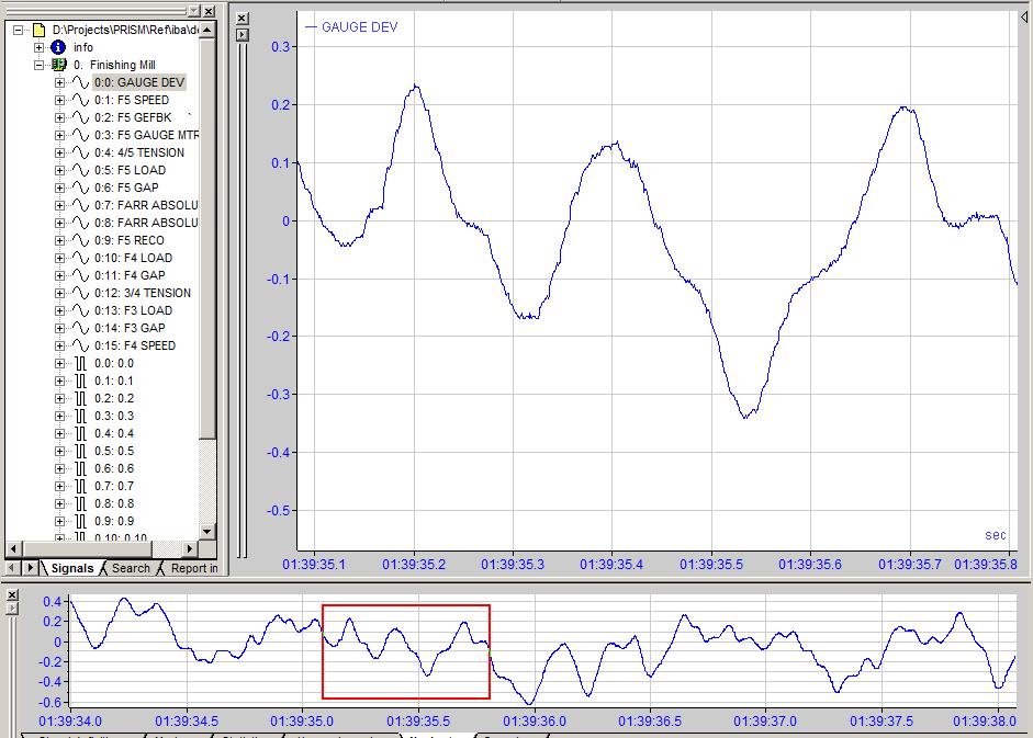

I am using teechart to make my historian trends. I have 2 charts, first one for full trend and second one for displays pan data from first one.
And I create a rectangle in first chart to get pan window. I want to display all data in pan window to show in second chart.
Has anyone got this code or has made the same with this issue?
Please, help me.
Thanks in advance!
Please, see the attach file
I want to make like this image

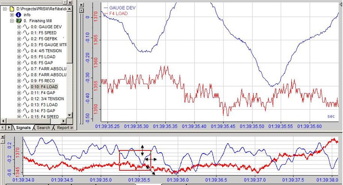

Your sample is very nice. But I want to create pan window by RECTANGLE because I want to DRAG and RESIZE on both side (Vertical, Horizontal, Both).
Could you please help me?
Please, see the attach image!

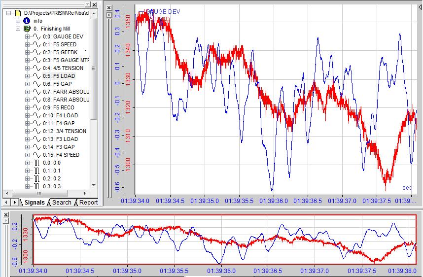

How can I set the area limitation of rectangle only in DATA AREA like below image?
(If I don't set limitation the rectangle will exceed DATA AREA when I drag or resize)
Could you help me?
Thank you very much!
Best regards
