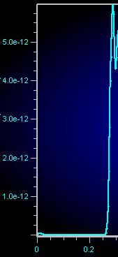

I upgraded from TeeChart 2012 to 2015.16 and now the left axis labels are behaving strange for the same code. It is not creating all the tick labels like it did in 2012. I am dealing with very small numbers (1e-12), so I don't know if that has anything to do with it. Also, it tends to set the minimum to an extremely small number (and sometimes negative) even though the data is no smaller than 5e-18.
Here is what a plot looked like with 2012:

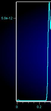

Here is what the same plot looks like with 2015.16 running the same code only linked to 2015.16:
In an attempt to fix this issue, I have tried programmatically setting the left axis properties including auto versus manual min max settings. Nothing I've tried fixes this.
Any insight would be appreciated.
