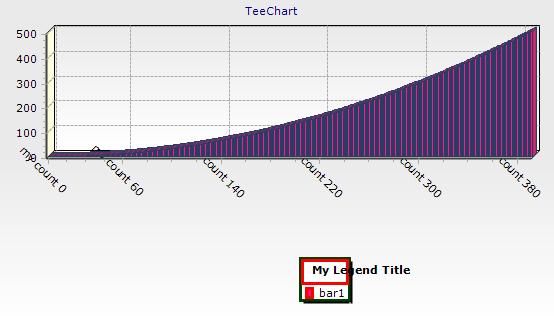

I did not write any code. I just set up a graph using your editor and get the following result:

Sometimes an image is more clear than a thousand words ;)
I understood now what you mean, I could reproduce it with the following code and I've added it to the wish list to be fixed in future releases (TF02014531).
