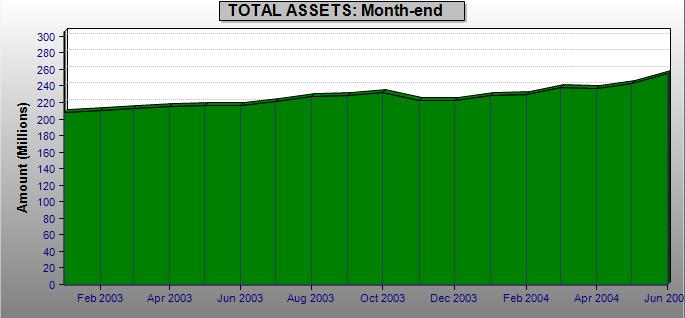

I have an area graph. Really, nothing special about it. No null points, about 20 points total.
Area graph.jpg (27.33 KiB) Viewed 3432 times
But if I make marks visible, I am getting "Object reference not set to an instance of an object" error with the following stack:

Hi UserLS,
Please, could you send us a simple example project we can run "as-is" to reproduce the problem here? I've tried with the following code but I'm probably missing to set some important property.
            Steema.TeeChart.Styles.Area area1 = new Steema.TeeChart.Styles.Area(tChart1.Chart);
            area1.FillSampleValues(20);
            area1.Marks.Visible = true;
