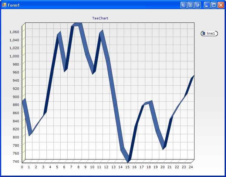

I'm having problems with the painting of the legend in the latest v3 release. I installed the 3.5.3575.14456 update build version.
Now every legend in my application is drawn like in this sample application that I created (top line dissapeared and quality of border is much worse than before):
This doesn't look anymore like it used to look in previous versions. You can easily reproduce this by making a new project, adding a TChart to add, set the legend to display the series names, and set in Format a round border.
Btw... the designer editor of TChart is not properly remembering this round border checkbox.
Btw... it looks ok in the designer, but not once you run the application.

Hello dimitrig,
I could reproduce you problem using last versions (3 and 4) of TeeChart.Net. I have added this in Bug Report with number [TF02014538], and we try to be fixed in future releases.
