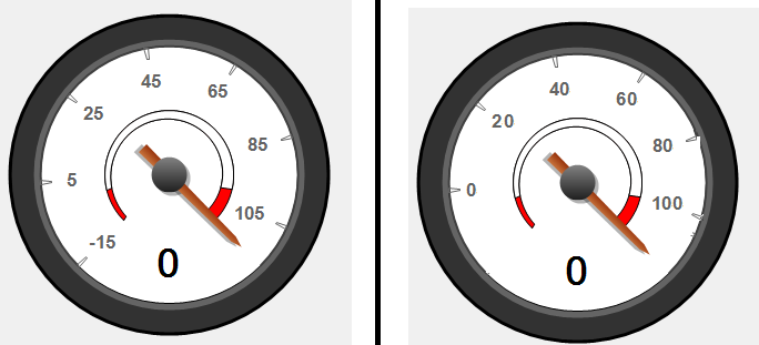

Is there a way I could change the Minimum Tick value on the circular gauge?
I am using VB.net.
For example, I would like my gauge to have a range from -15 to 115, but I want the first tick value start at 0, and then increment every 20.
What i have now is pictured on the left, and what I would like to have is pictured on the right. (just edited the first in paint)

I recommend you, change values Minimum and Maximum of your gauge Series and modify the Increment of Left axis as do in next simple code:
            Steema.TeeChart.Styles.CircularGauge gauges1 = new CircularGauge(tChart1.Chart);
            gauges1.Minimum = -15;
            gauges1.Maximum = 115;
            tChart1.Axes.Left.Increment = 20;
            (tChart1[0] as Steema.TeeChart.Styles.CircularGauge).Minimum = 0;
Can you please, tell us if previous code works as you expected?

No, That only set the new minimum value to 0, so the whole gauge just starts at 0 instead of starting at -15
I have solved this by just disabling the Automatic Ticks and Labels, and drawing my own on the AfterDraw Method.
Thanks for the response, you can consider this topic solved.
