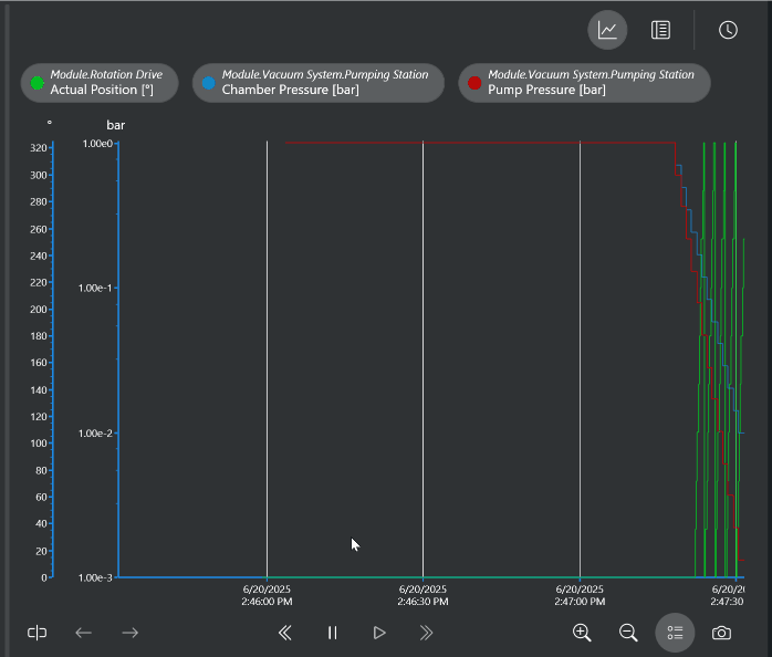

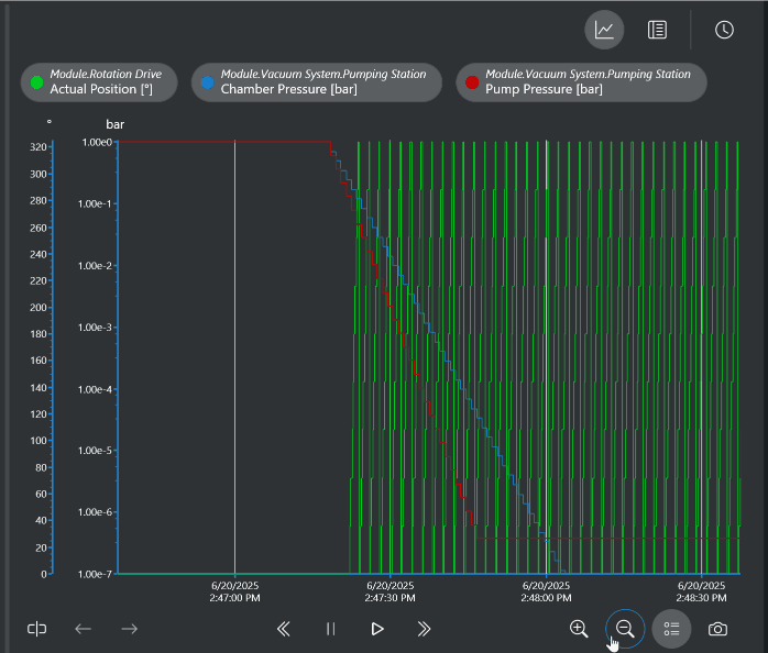

here are a few screenshots of my chart.
In the chart I show data depending on the time. The chart is a live chart. In the chart I want to correlate different values over time. Therefore I have defined two y-axes which are independent of each other. The x-axis is the time axis.
In the chart you can see the pressure (logarithmic axis) and the position of a turntable.
Our zoom is defined in such a way that I only ever zoom over the time axis.
Note: Even if I activate the mouse zoom and configure it so that I can only zoom horizontally, the min/max is set for automatically scaled axes. I think it is wrong, that the automatic scaling is deactivated when zooming mode is horizontal.

Post by Marc » Fri Jun 20, 2025 2:27 pm
Hello René,
Re.
Yes, good point. If the zoom is horizontal-only then vertical axis settings (automatic included), shouldn't be affected. We'll check that and consider related factors.
